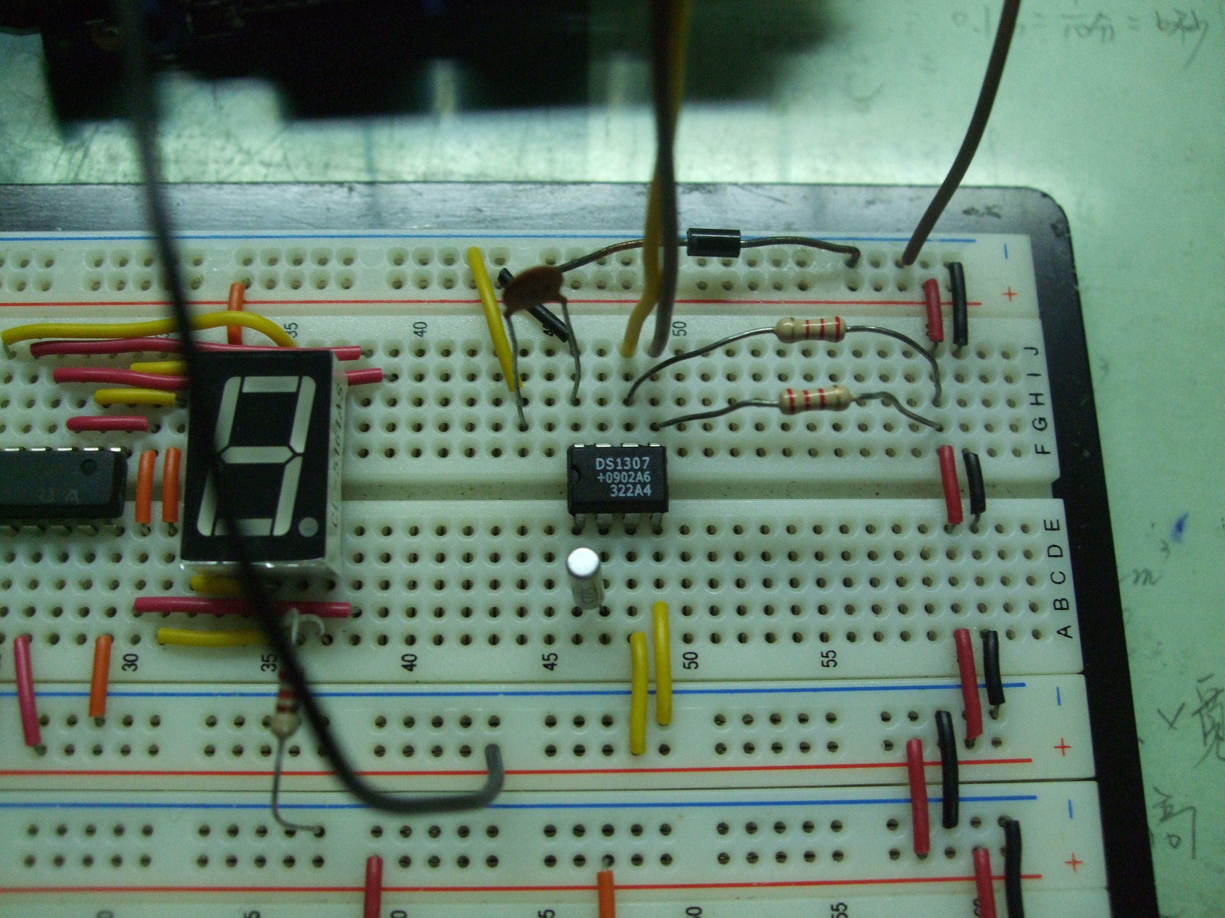

本帖最後由 karta282036 於 2014-2-9 21:52 編輯 誰可以幫幫我!我快要把板子砸掉了!我有給它 ARDUINO官方的RTC程式 Time, TimeAlarms, and DS1307RTC http://playground.arduino.cc/Code/Time 都有下載給他!! ...

vegewell 發表於 2014-2-11 11:45:52
回復 1# karta282036
如果你的arduino mega硬體沒問題的話,
只是 bootloader 程式糢掉了,
那你要為arduino mega重新安裝bootloader,
如果你手上另一塊板子,
那就容易,
這個網頁有在教:
Atmega bootloader programmer
http://www.gammon.com.au/forum/?id=11635
Yes, on mine it is between the reset button and the processor chip.
If there is another ICSP header near the USB port that is for reprogramming the USB chip.
If you can't get avrdude to work, this post describes a way of uploading the bootloader if you have a spare Uno around:
